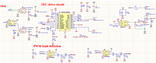

  • Hi ,
    Thank you for your reply. And the customer also provides the image below, could you help review this?
    Thanks again!
    Cherry
  • Hi Cherry,
    Is this a 4 layer board? If it is only a two layer board, I think the thermal performance of this board will not be good. You need to have enough GND copper connecting to the GND thermal PAD of the DRV8873. Also, if there is enough space on the bottom layer, there should enough a large area of GND underneath the thermal GND PAD of the driver to help with thermal dissipation. If 4-layer board, having a dedicated GND layer will drastically improve the thermal performance of the board.
    I strongly recommend re-designing the board if possible to improve the thermals. Specially since the customer is driving high currents (up to 5-A at maximum operation). Make sure to follow the guidelines on the app-note I linked in my previous reply.
