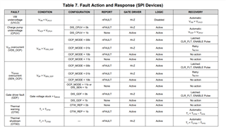

  • Hello Kengo-san,
    It mainly depends on the fault that you are running into and the type of device you are using (Hardware version or SPI version).
    There are a couple of different methods from recovery after a fault occurs. For example UVLO is automatic. Others are latched which require you to clear using an enable pulse 8 to 40 us long in order to clear the faults. In some configurations they use the retry where it will retry in 4ms to see if the condition still exists. Quantifying the time can be a little difficult since there are various options, but I hope this helps you understand the difference between each one.

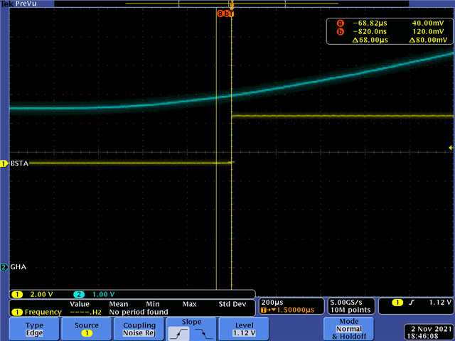

  • Hello Kengo-san,
    I took a measurement on the EVM, it looks like once the conditions are met clearing nFault going high took ~1.2us. The timing from meeting the fault condition to nFault starting to go high is not as exact since I cannot get a fine enough measurement on the scope but it looks like it is approximately ~50-70us.
    If there are other components on your nFault pin then the rise time might vary. On the EVM we have an LED to indicate when there is a fault so if there is no LED on your system then rise time my vary.
