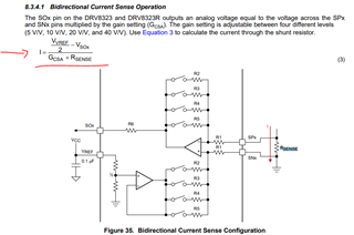

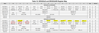

    The first thing I want to confirm with you is which type of overcurrent (OCP) fault is happening
    • in our system, there are two types of OCP fault monitoring:
      • Current sensing 'SEN_OCP' which reports faults to the 'SA_OC, SB_OC, and SC_OC'  register bits circled in red on the register map
        • this involves the current shunt amplifiers to detect motor phase current flowing through the Rsense resistors
      • Vds sensing 'VDS_OCP' which reports faults to the 'VDS_HA/B/C and VDS_LA/B/C' register bits highlighted in yellow.
        • this involves monitoring the voltage drop between drain and source of each external MOSFET, and relies on the MOSFET's Rdson value
    • Question: can you help check these SPI registers and let me know which ones show up as a fault bit = 1?
    In the case of the 'SEN_OCP' type coverage, let's take a look at your current settings and the EVM parameters.
    • Please refer to datasheet section '8.3.4.1 Bidirectional Current Sense Operation'
      • it looks like you are using bidirectional current sense mode, since your code setting for VREF is 'VREF_DIV = true;'
      • this section will explain how the current sense feature works, given by the equation (3) in the image attached
    • your CSA gain setting is 10V/V, and the Rsense resistor looks like it is 7mOhms, according to the schematic
    • Question: What is your input voltage on the VREF pin?
    • Question: when you monitor the current shunt outputs (SOA, SOB, SOC), what voltages are you seeing?
      • what about the voltages observed on SPx and SNx?
      • if you have some waveforms to share on this, it may help debug the situation.
    • Question: what is your 'SEN_LVL' setting for the current sensing overcurrent trip voltage? (see image below)
    • Debug action: My suggestion is to try out different settings for CSA gain, VREF input voltage, and SEN_LVL trip threshold according to the datasheet information and the equation below
    In the case of 'VDS_OCP' type coverage, the highest 'VDS_LVL' setting is 1.88V like you mentioned.
    • checking the MOSFET 'CSD88599Q5DC' Rdson value as being only ~2mOhm,
      • you are most likely not triggering a VDS-type OCP, since:
        • V=I*R has 1.7V = I * 0.002, resulting in Itrip = 850A for this specific MOSFET on the EVM
        • I think you can use a much lower setting for this in general, since VDS_LVL=0.06V will result in an OCP trip point of ~30A for this MOSFET
