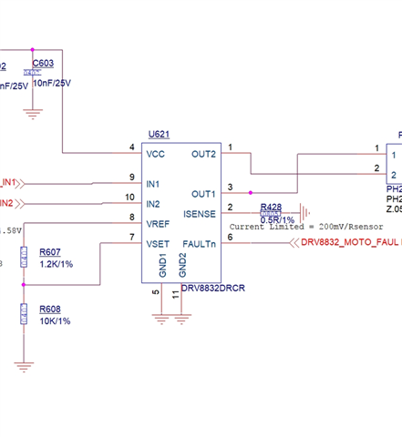

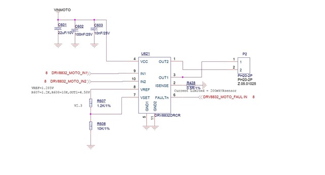

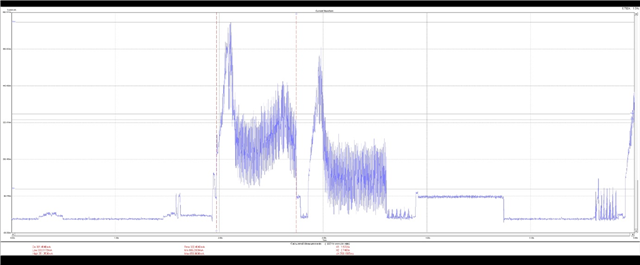

DRV8832 occasionally damaged after working for a period of time. damaged part is shorted between VCC and GND.
now we have no idea why this happened
below is the schematic:

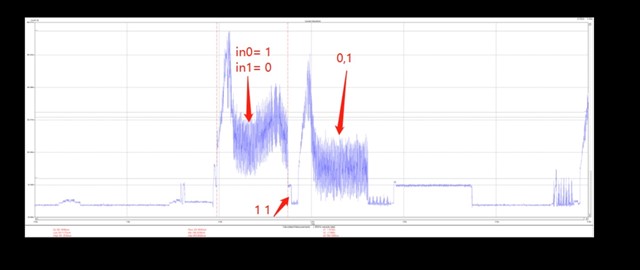

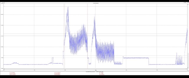

and below is the test result of OUT1/2. the two pictures are the same because the second  one cannot see the clear axis.
