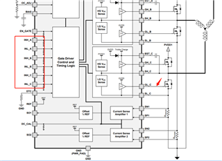

DRV8302: Driver output GL_C signal abnormally
Part Number: DRV8302
Hi team,
After power up, the MOS tube is turned on incorrectly when the GL_C signal has a 1.8-V fluctuation voltage without a PWM input (standby).  The customer has checked the GL_B, GL_A , and did not find a problem.
Could you please help resolve this case? Thanks a lot.
Cherry
  • Hi Cherry,
    Is the PWM input floating? Can you check if INL_C still has 100k pulldown to GND using a DMM?
    Are you using gate resistors at the gate outputs?
    Is GVDD stable and around 10-12V?
    It may also be good to see the schematic and/or layout of the customer's board.
    Aaron
