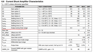

Hi Team,
The DRV8301 manual does not clarify the output linear range of its internal current sense operational discharge. While the DRV8323 manual has a linear range for internal current detection and operation, the customer would like to know if the linear range for both chips is the same.
Could you please help to check this case? Thanks!

  • Hello Cherry,
    Thank you for posting to the MD forum. It seems like there is a spec on the datasheet for the DRV8301, it is just labeled differently than it is for DRV8323. I have attached a screenshot of section 6.6 of the datasheet, the spec is labeled V_swing instead of V_linear. I hope this answers the customers questions!
    Isaac
