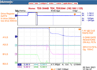

    Now with more testing, triggering with an SPI write to the RSTEP bit (CTRL register bit 2) OR triggering via the STEP pin (pin 10) are producing essentially the same FAULT of PDF.  I can send 100 SPI writes successfully, but I can get it to FAULT with an SPI write to RSTEP now.  I can now also get it to step 30 to 50 steps via the optically isolated STEP pin.
    I am running a nominal 20 Vdc as Vm.  I am regulating around 1 amp phase current to the stepper.  I am using IRF4110 FETs with a total gate charge around 150nC.

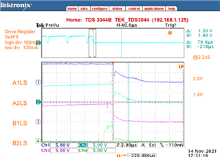

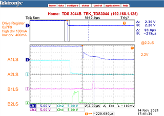

    I now have a hundred or so scope traces captured.  To me, every one is showing a gate voltage on either A1LS, A2LS, B1LS & B2LS ABOVE 1 volt at 2.2uS after start of transition.  I have documented the entire matrix of IDRIVEN (100mA, 200mA, 300mA, 400mA) and IDRIVEP (50mA, 100mA 150mA, 200mA) and all combinations trigger the PDF fault.
    I am attaching two annotated scope traces below
    I thought I would look at both sides of the 47 ohm resistor on A1LS.  I found this interesting as there is about a 400nS period right after switching where it appears the DRV8711 has a very low Z to GND.  I have checked and rechecked the drive register and I have TDRIVEN and TDRIVEP both set for 2 uS.
    To me it now looks like an excursion above 1 V at the 2.2uS mark.  Are the FETs I am using just not compatible with the architecture of the DRV8711 with 150nC total gate charge?

  • Hi Dave,
    Thank you for providing the plots and information.
    There are 47 ohm resistors between A1LS, A2LS, B1LS & B2LS and their respective FET gates
    There are  0 ohm resistors between  A1HS, A2HS, B1HS & B2HS and their respective FET gate
    May I ask why you use gate resistors for LS FETs and not HS FETs. This will cause a mismatch on the output voltage slew rate even if same IDRIVEN and IDRIVEP are chosen. Can you remove 47ohm resistor and replace with 0ohm. See if that helps.
    Interesting. The only setting you changed was the stepping rate (to half-step) and the stalln and BEMF settings. I don't think the BEMF is affecting the PDF faults. Somehow increasing the stepping rate is making the PDF faults occur when controlling via SPI. I'll need to look into this to really understand what is happening.
    I think the 47ohm series resistor is limiting the IDRIVE current too much and not allowing the gate voltage to increase to its final value. As I suggested above, please remove the resistor or short it. This should allow the gate voltage to increase to it's final value.

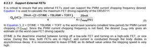

    Did you follow the recommendations in section 8.2.2.3 of the datasheet? Please double check the Qg of your FETs meets equation (9) based on the settings you've chosen.

    Calculation of maximum gate charge:
    Q<20mA*(2*Dtime+Tblank+Toff)/4 = 20mA*(2*850nS + 1uS +50 uS)/4 = 264nC  Looks like I am OK at 150 nC for IRF4110 FETS

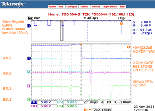

    Here is the PDF trigger with Zero Ohm gate resistors in all positions.  It is cleaner, but still tripping the PDF by 400 millivolts
    So now I changed out the FETs to IRF640s with about half the total gate charge at 70nC and 1300 pF gate capacitance.
    Much cleaner and NO PDFs!  Yay.  Looks like your recommendation to remove the gate resistors was a good one, and going with a FET with lower gate charge appears necessary with my parameters.
    I am now chasing layout related anomalies, but that is all on me.  Going up to 48 Vdc and 7 to 10 A currents needs more work in cleaning up the noise that is floating around.
    Thank you for all your help Pablo, and I hope this thread is helpful to others spinning up a stepper driver with this chip from scratch.
