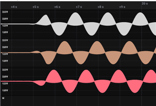

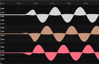

    CSA gain was 20V/V. I tried 10 and 5V/V and changed USER_ADC_FULL_SCALE_CURRENT_A accordingly, but I still have the same issues...
    I measured the SOx outputs from the DRV8323 with 20V/V and 5V/V amplification (see pictures below) and you can see that neither of them exceeds the 3.3V reference voltage. So the CSAs should be fine, right?
    20 V/V amp:
    5 V/V amp:
