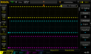

We have observed in other devices a means to lock the rotor into a stationary angle. This is accomplished by pulsing the 50% duty cycle voltage waveform at 26KHz to all 3 motor phases at once. The slight time delay between the 3 phases voltages rising will allow some current to flow from phase to phase at the rising and falling edges.
