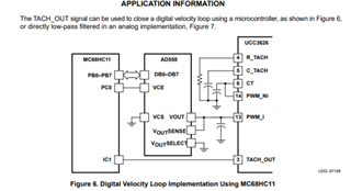

The customer would like to know is it possible to provide the UCC3626 application note, and from the TACH_OUT feedback signal to PWM_I, how to speed up?
Could you help check this issue? Thanks.

Hi Cherry,
I found information of UCC3626 application with TACH_OUT here in the datasheet:
You can also use TACH_OUT as an analog input to a comparator with a speed set comparator that enters in PWM_I. The + input to the comparator can be a speed set signal, such as the output of a potentiometer, so the analog signal generates a varying PWM duty cycle output into the PWM_I and PWM_NI pins.
Please see the velocity controller schematic (Figure 17) in the datasheet.
