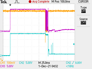

    I evaluated the motor that causes the issue more frequently and observed the following:
    up to 13V, the motor driver will be able to operate simply by toggling the phase and enable pins (not resetting the sleep pin), if the enable pin is stopped prior to the motor stalling.
    At 14V and above the motor driver needs the nSleep pin to be reset after every operation, whether the operation occurred or not.
    Despite the behavior observed just the other day, the actuator was not able to shift at 16V today. However, I was able to get a screen shot of the waveforms on a failed attempt at 15V.
     Iout had a transient of -10.1 A, and then 6.81 a for roughly 10 ms
    Vout 1 and 2 had their rise when nSleep was given 5V, and dropped when Enable was given 5 volts
    This is what the Vout wave forms looked like after that 10.1 A current transient.
    The transient suggests to me that we are absolutely hitting the OCP limit. But this is leading to more confusion on my part: do the Iprop resistors not limit the current? Earlier you had mentioned that the slew rate could help with transients, but will a slower slew rate also mean that the motor is slowed down? We are looking to maximize the torque and speed output of this motor, which was the reason for evaluating the 8873 as a potential upgrade compared to the 8872.
    Again we are more than open for a conference call to see if we can clear some of our confusion.

  • Good afternoon Pablo,
    I placed a 10k pull up resistor on the nFault pin, but it is going to the external 5V supply rather than DVDD due to the board design. anyway here are the screenshots:
    This is the zoomed out shot
    This is just the current and the nFault pin. Current transient went to -9.1A, and the steady current for the 7.5 ms was about -6.91 A. The nFault signal went from 520 mV to 0V (Is 10k too large of a value for the pull up resistor?)
    This is a close up that shows what the Vout signals were doing in the same time frame.
    I hope this is helpful.
