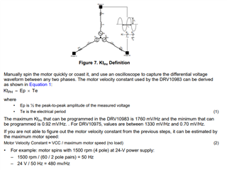

  • Hello Jain,
    Thanks for the info. Did you verify the BEMF constant (Kt) with the motor datasheet, if not found in the motor datasheet you should also be able to calculate the Kt value to see if that addresses the abnormal speed behavior? I have attached an image from the DRV10983 tuning guide which I have linked here:
    Isaac
  • Dear Isaac,
    Yes the BEMF constant in calculations came around 52mv/Hz, we have kept it at an lower value of 47.7mv/Hz because we have observed the BEMF value ranges between 37 to 54 mv/Hz in the estimated Kt as the speed varied so we kept it at mid-point value and also there is a slight increase in speed over time without any increase in command when kept at 52mv/Hz setting.

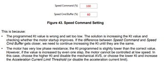

  • Hey Jain,
    This definitely sounds like a system tuning issue to me. Have you tried using the lower or higher limits of your Kt calculation to see if this changes the behavior in any way?
    My thought is that perhaps that we do not have the best Kt constant programmed into the device, this is something we touch up on in the tuning guide I mentioned above. Which coincides with the points you brought up in your previous post (reason I was asked for Speedcommand and the Speed CmdBuffer values). If you are seeing a disconnect between your Speed Command and Speed CmdBuffer where the values of the buffer is lower than the commanded speed means your Kt values is too low for the device.
    A higher Kt value can make the motor more difficult to control at low speeds, and if you have a high enough Kt value with mechanical AVS enabled it would prevent you from decreasing the speed so the buffered value would be higher than the commanded speed value. The reason this occurs is because the mechanical AVS prevents the voltage generated by the BEMF of the motor to be higher than the voltage that is applied to the motor by the device. To me it sounds more likely that you need to increase the Kt value and perhaps disable the Mechanical AVS as mentioned in point 2 from the image above. This is what is probably from increasing the motors speed but also causing the instability at low speed.
    Regarding point 4 above: Are you observing this high RPM, is this being calculated by your external MCU, or is this just being observed in the motors behavior?
    Just so that you are aware there is an issue with the GUI calculation for RPMs so we recommend using the Motor electrical period and converting to mechanical speed or using the FG output. You can read about this in this post: https://e2e.ti.com/support/motor-drivers-group/motor-drivers/f/motor-drivers-forum/933806/drv10975-speed-vs-rpm?tisearch=e2e-sitesearch&keymatch=DRV10975%252525252525252520GUI#
    I hope this helps!
    Isaac
