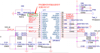

  • Hi Dear Pedro,
    Thanks for your support and here comes some additional questions:
    1. What's the purpose of driving the IC DRV8818 HOME pin? Can the drive IC DRV8818 signal the master detection after the motor is blocked?
    2. The stepper motor drive is powered by the DRV8818 using VCC 3.3V, and currently when debugging the circuit, the PIN2 pin (HOME pin) actually outputs only 1V high, The PIN2 pin is normally at a minimum high level of 0.7 VCC ,what is the reason for that?
    Could you also help check this? Thanks.
    Cherry
  • Hi Cherry,
    Regarding the home pin, you do not need to drive, it is instead an output that can be read. It notifies the user when the device is at the home step of the logic table. This should be at 45 degrees of step angle. Attached is a table that explains it's function:
    Regarding if the DRV8818 can signal the master detection after the motor is blocked; it unfortunately does not have stall detection capabilities. Devices that feature it at the moment are the DRV8889Q1, DRV8434A, and the DRV8434S. However if you really wanted to know if the motor is stopped you could attach a current monitor to one of the windings, if the current shoots up for a transient while the motor is static then it could signify that the device is stalled and current regulation kicked in.
    Regarding your second question about the Home pin, at 3.3V the low output should be around 1V (0.3*Vcc) and this should only happen when the indexing table is in the home position, the high output should be around 2.3 V (0.7 * Vcc) and this should happen at any other position rather than home. Is this not happening at the moment?
    Pedro Arango Ramirez
