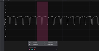

We put a logic analyzer on the battery and can see about a 20khz oscillation in the output. Looks like the motor output has about a 20% on duty cycle, even with 100% PWM.
  • Small correction, its oscillating about 5khz

  • We don't have a current probe. But we can monitor battery voltage with a high speed analyzer, which gives us a very good indication. There is nothing that correlates to the 4mS over current event. At startup, the driver will oscillate at about 5khz for the duration of the programmed on time, which is about 100mS. We've tried various SR from 1k to 100k, but seems to make no difference at all.
  • In this example, we are monitoring battery voltage. You can see when the driver is on/off by the voltage drop. In this example, you can see we are ramping up the PWM from 10% to 100% in about 30mS. But after about 14mS, the driver starts to oscillate at about 5khz. Its roughly a 20% on duty cycle. Its rather random. Sometimes it will oscillate immediately, even at 10% duty. Sometimes never.
    Now zooming in just after that 14mS period, you can see the oscillation. You can also see the PWM interlaced on top of it.
    Based on the low power, even when functioning, I'm guessing this is related to the gate voltage of the drivers. They are not high enough to fully turn on the high side N channel MOSFET. But its hard to guess, because we can't monitor whats happening in the chip.

    Hard for me to see in plots.  What is the supply voltage on the DRV8850 dropping down to?
    Ryan
  • In that example, it dropped to about 3.85V. But it really doesn't seem to be related to voltage. Same problem with fully charged or discharged battery.
