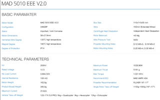

I'm using the 180kv version of this motor, still trying to get all the specs, will post update when I get them.

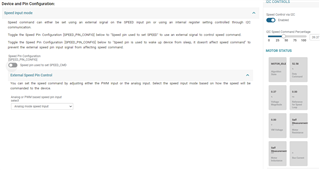

    Thanks for positing your question in MD forum. Firstly, I want to check if you followed the instructions mentioned in the Essential controls in the "Guided tuning" section of the GUI (see screenshot below). Was the device able to run MPET successfully? Can you share the phase current waveform and the register settings?
    Vishnu

    As far as register settings, I have reset those to default - the only changes after that are for the 14 pole pairs of my motor and 2160 RPM for the 180kv rating of the motor (at 12V).

    Yes, you should see the device read back 12V Vm voltage under "Motor status". Can you make sure you enabled "Auto read motor status"? Are you issuing speed command using the potentiometer or I2C? If you are commanding via I2C, make sure [SPEED_PIN_CONFIG] bit and "Speed control via I2C" are enabled. Slide the I2C speed command percentage to issue speed command via I2C.
    Vishnu
    I have done this both ways.  Using the pot and the slider.

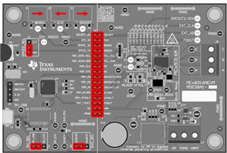

    Looks like the device is not connected to the GUI. Do you see "Hardware connected" text at the bottom left of the GUI? Can you click "Read all registers" and see if you get a message at the bottom left of the GUI saying "Read xx registers"?
    Also, can you check if the switches S1, S2 and S3 are flipped in the right direction as shown in below screenshot?
    Vishnu.
  • Of course, the board has been connected, we're way past the "is there gas in the car" diags.  And yes, the switches and jumpers are just as the diagram and all the reference material indicates.
