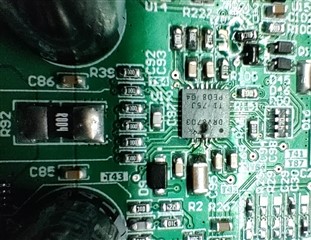

We are using the DRV8703-Q1, to drive a 30V/350W PMDC motor, with suitably sized MOSFETs (1.9mOhms / 60V). When we stop the motor (via Signals PH/EN), we are seeing physical failure (package burnout / damage) of the DRV8703-Q1. This happens at 100% PWM as well as lower PWMs. We are not decelerating the motor in this case, its an abrupt stop (emergency stop).
There is no load on the motor, just a gearbox.
We are seeing two types of failures
1. The physical failure is near the Vm pin (physical proximity - this may not be the Vm pin itself).
2. The physical failure is on the Vm pin(image below).
This is a HVM product and we need to get to the cause of these failures and fix them thoroughly asap to go into production. I can share more details as needed to troubleshoot these.

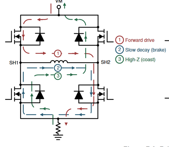

    Firstable, I think you are mistaking coasting for brake (slow decay). Below is a diagram of the H-bridge. The VM pumping occurs when the current flows back to the VM supply which happens when coasting (all FETs High-z). To prevent VM pumping, the decay mode needs to be set to slow decay (brake).
    2. So I am now making both PWM signals low (coasting) when I want the motor stopped
    The PWM signals need to be both HIGH to stop the motor. (sets it to brake mode)
    3. To run the motor I am initially making both PWM signals high (brake slow-decay).
    Can set both signals LOW to disable all FETs when not driving the motor.
    when going from driving to braking, the PWM duty cycle will be flipped. Meaning, to increase the motor speed, the duty cycle of the corresponding output will need to be lowered.
    Other than that, I think this procedure works. We offer the two decay modes, braking and coasting, to allow for more design flexibility.

    I also see the diagram you have shared and that is showing a current path through body diodes when the MOSFETS are Hi-Z.
    Please help understand.

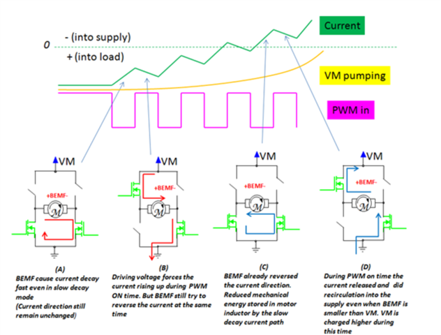

    Sorry, there was some confusion from my side. Let me clarify and explain VM pumping in simpler terms. The article may have been a bit confusing to understand.
    VM pumping is caused when there is a build up of reverse current (opposite to the original current direction before deacceleration) during the slow decay phase (PWM off time). During slow decay, the current in the motor will begin to rapidly decay and after some PWM cycles, the BEMF will overtake the VM and reverse the motor current direction (as shown in block C on the image below). At this point, the motor is effectively behaving as a generator and will pump current into the supply during the PWM ON time (due to the inductive nature of the motor).
    The reason why VM pumping does not occur during coasting (all FETs disabled) is because the current direction is not being reversed during deacceleration so the motor never behaves as a generator. Likewise, when deacceleration directly to 0% duty cycle, even in coast mode, there is no time for the current to reverse and VM pumping will not occur.
    The best way to minimize the VM pumping is to gradually decrease the PWM duty cycle over a longer period of time (when in coast mode). This will prevent the current from rapidly decreasing.
    Another option is to operate in coast mode which has the tradeoff of lower effeciency and motor control specially at lower duty cycles.
    The procedure you described in your earlier post is acceptable. During normal operation, you can alternate between driving and braking. During de-acceleration,you can switch from driving to coasting.
