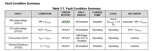

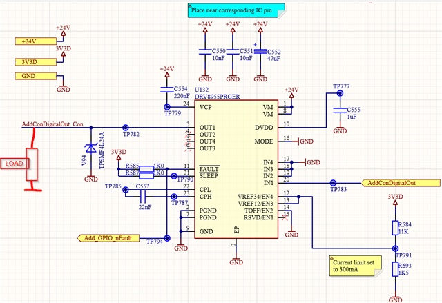

My customer is using the DRV8955, they are controlling the input pin by an FPGA, this works fine:
For an input of 3.3V the output is 24V
For an input of 0V the output is 0V.
If they have a resistive load with a current higher than the selected limit they are not getting an nFault.
Their idea is to use the DRV8955 as a "kind of eFuse" to switch off if the output current is > 300mA.
Can you comment and review the below schematic ?
