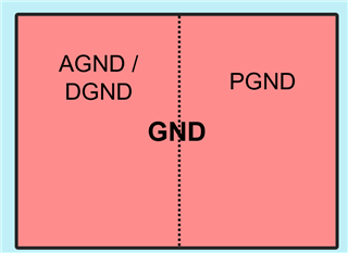

    Thanks for sharing schematic. Shared GND should not be an issue as long as motor current, when switching, does not couple noise into digital signals. Only issue is that when using common GND, if the power and analog/digital signals are mixed in layout, then it increases the risk of noise coupling. It is best to place PGND on one side of board, and AGND/PGND on other side of board (i.e. star grounding topology).
