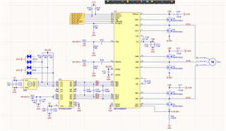

Hi everyone,
This is my schematic:
And source code:

  • Hi Kevin,
    Can you please:
    • Set ENABLE = 1 first
    • Wait 1ms for device to wake
    • Set BRAKE = 1 and DIR = 1
    • Set PWM
    Currently you set ENABLE = 1 and then the next lines of code set the PWM. See if adding the twake time helps the application.
    Other things you may try:
    • Set the IDRIVE to a lower setting
    • Ensure the phase current is aligned with the phase voltage. If not, a lead angle may need to be applied to the solution.
    Aaron

  • Hello Kevin,
    Thanks for the feedback. It is interesting that another type of motor does not encounter the same problem as the WS7040-24-V200 motor that you are using in the video above.
    As Aaron recommended above, you should monitor the phase current to make sure that it is aligned with the phase voltage of your motor. This would also be useful to check at startup to see if there are any differences in startup waveforms between the two motors.
    Another thing to check would be the hall states, they can sometimes be an issue in sensored system. Such as if the hall states are not indicating the right state so the motor could be energized incorrectly or may sometimes get stuck in a state. When you move the rotor this could cause a state update and the systems proceeds with the algorithm as it should.
    Isaac
