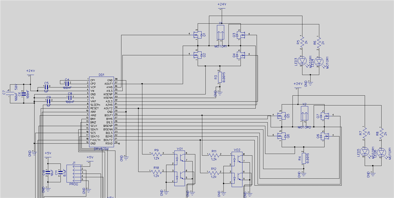

Schematic as follow

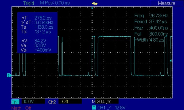

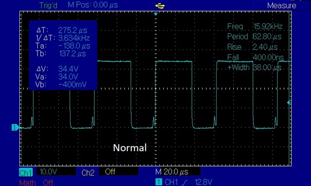

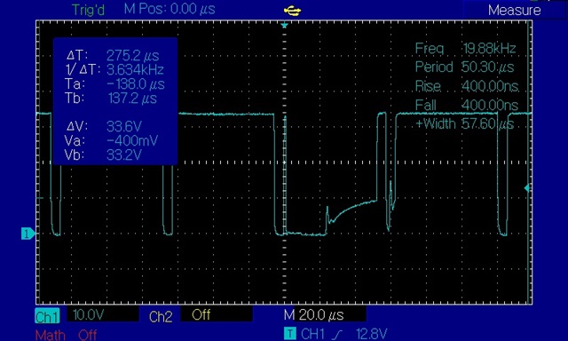

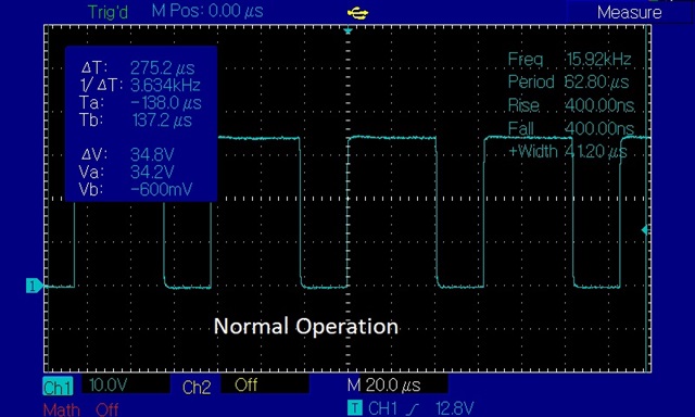

  • Hi Pablo
    Thanks for the reply.
    I have manage to capture some waveforms on the gate pin of mosfet. Sometime the wave is perfect (photos with normal written on it).
    I noticed, when the wave goes abnormal, the frequency goes up(unstable) and motor is stalling and making inconsistence high pitch noise.
  • Hi Richard,
    Thanks for providing the waveforms. There abnormal gate voltage is definitely causing the PDF fault. The abnormal waveforms seem to be the result of current regulation. In a previous post, you mention that increasing the DEAD time to 880ns helps with the current regulation issue. What exactly is this current regulation issue? Does the PDF fault go away when increasing the dead time?
  • Hi Pablo
    with Dead time and Isgain at default values. The current can only goes up to 15A, as soon as it draws over 15A, it was chopped to 10A.
    Then I changed the isgain from 40 to 20v/v. It went straight to PDF fault every time.
    and then I also increase the dtime to 880ns, it is able to handle 25A, with occasionally pdf fault and abnormal waveforms as pictures above.

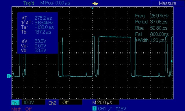

  • Hi Ryan
    I have managed to cut the traces and place 47ohm resistor between drv8704 and low side gates. it doesn't help much.
    However, i tried to change isgain down to 5v/v. The waveforms become normal regardless the load. And the frequency become stable.
    But the Pre-driver faults still occurred. it happened at beginning of the action when i change the motor direction. even-though i placed 2 seconds delay between change of directions.
    Here is the waveform i catch when the PDF fault happened, it only does on and off then PDF fault.
