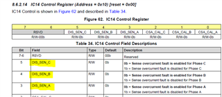

    An easier solution would be to evaluate the DRV8343S-Q1EVM, which I still see stock on ti.com. Then in SPI you can disable the CSAs through these registers:
    Then set the settings the customer would use on the DRV8340H, and this should give the equivalent functionality of evaluating a DRV8340H using the DRV8343S-Q1EVM.

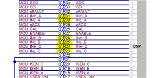

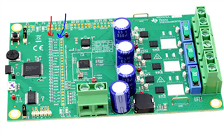

  • Yes, they have some question.
    Since my customer would like to control DRV8343S-EVM with their own MCU.
    They would like to know :
    Is it possible to disable the EVB MCU? so that they could connect it with their own MCU.
  • Hi Aaron,
    Best way to accomplish this is to depopulate 0-ohm resistors (red arrow) between MSP430F5529 MCU on the EVM and populate the 100-mil header row on the EVM (blue arrow). Then jumper over signals from customer's MCU to the header row.
    Aaron

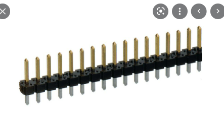

  • Hi Aaron,
    I see, you mean removing the 0ohm resistance.
    Then, soldering 100mile header row in blow row, right?
    The header row that you mentioned is the below things, right?
    From my understanding, removing the resistance will cut the connection of MCU?
    Am I making sense?
  • Hi Aaron,
    Yes, that's correct. Using 0-ohm resistors is common because it's easy to remove the connection without having to break the trace. The headers make for nice test points as well.
    Aaron

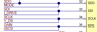

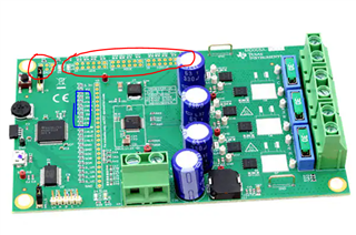

  • Hi Aaron,
    My customer were testing the DRV8340S-EVM, if they would like to test it in independent MOSFET driver mode, and control by hardware interface.
    May I know how to connect the following 4 pins?
    BR,
    Aaron Chen
  • Hi Aaron,
    On DRV8343S-Q1EVM, the DRV8343 device is SPI variant and the H/W variant headers are automatically depopulated (see red circles):
    To use the hardware device on this EVM, you'll need to:
    - Replace the DRV8343S-Q1 with a DRV8343H-Q1
    - Depopulate the 0-ohm resistors for the SPI pins (SDI, SDO, SCLK, nSCS) between the MCU and header row: R29, R33, R34, R35  (see blue circle)
    - Add headers for the hardware variant jumpers and use a shunt jumper to connect the correct settings as mentioned in the User's Guide
    In my opinion, it would be easier to just use the DRV8343H-Q1EVM instead since it has everything already configured for the hardware variant of the device.
    Aaron

    Here's what you can do but use the customer's 6 PWM signals from their MCU, instead of the PWM signals from the MSP430F5529:
    1) Populate the header row on the EVM
    2) Depopulate these resistors: R23, R24, R25, R26, R30, R31
    3) Jumper over the customers 6 PWM signals from their MCU to the associated test points on the header row.

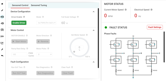

    5) Launch the DRV8343-Q1 EVM GUI.
    6) Click "Enable" to set the ENABLE signal high and enable the SPI logic.
    7) Set the SPI settings in the "Registers" tab to the same that the customer would like to set in DRV8340H-Q1.
    IDRIVE pin --> IDRIVEP_HA, IDRIVE_HB, IDRIVE_HC, IDRIVE_LA, IDRIVE_LB, IDRIVE_LC
    MODE pin --> PWM_MODE
    VDS pin --> VDS_LVL_HA, VDS_LVL_HB, VDS_LVL_HC, VDS_LVL_LA, VDS_LVL_LB, VDS_LVL_LC
    You can disable the VSEN_OCP faults from the CSAs by setting DIS_SEN_A, DIS_SEN_B, DIS_SEN_C to 1
    After these steps, you should be able to spin the motor using 6x PWM signals and hall sensors externally. This should be the same operation as DRV8340H-Q1, you should be able to ignore the CSA outputs. Recall that this method is the most ideal, since the other method would be to use DRV8343H-Q1EVM and cut the CSA input/output traces and tie the inputs to GND.

  • Hi Aaron,
    Yes, this should work from a hardware and firmware aspect. Thank you.
    If the GUI runs into any software overcurrent limit faults due to the CSAs outputs, we can figure out which settings in the GUI we can toggle to get rid of those so there are no dependencies on the CSAs in the DRV8343-Q1, which would make performance similar to DRV8340H-Q1.

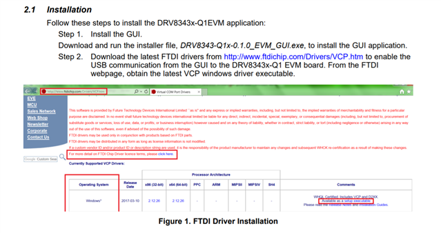

  • Hi Aaron,
    As the User's guide shows, may i know where can I get the DRV8343-Q1x-0.1.0_EVM_GUI.exe?
  • Hi Aaron,
    The GUI should be in the Firmware folder on the EVM page. I linked below.
    FIRMWARE
    DRV8343S-Q1 EVM Firmware (Rev. A)
    Aaron
  • Click "Enable" to set the ENABLE signal high and enable the SPI logic.

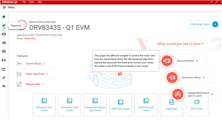

    Hi Aaron,
    After my customer click "enable", where can I set the step 7?
    BR,
    Aaron Chen
  • Hi Aaron,
    In the registers tab on the left.
    Aaron
