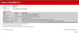

  • Ian,
    I am suspecting GUI Composer runtime may be missing or incorrect. This can be verified by looking at "Help > About" in the GUI. An example screen shot is below of what you should see (this is for another EVM).  Please send me screen shot from your install.  We've seen that sometimes network firewall prevents installation of the GUI Composer Runtime. In this case customer must do a reinstallation of the GUI app and during the process look for downloading Runtime to the local machine and install it from there. I hope this resolves the issue.

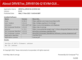

  • Thanks Ryan - I've got this:|
    It didn't say the install didn't work so are these versions OK?
    Ian
  • Ian,
    That does look correct.  When and where did you purchase the EVMs?  I am wondering if the firmware is out of date on the EVM.  The firmware version should be 1.5.  This will be difficult to verify if you can't connect.

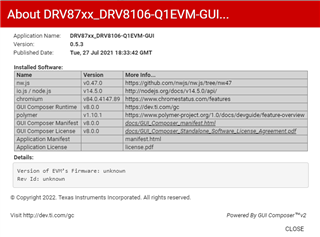

    As you say the GUI was updated in November I've tried using both v0.5.4 (early Nov 2021) and v0.5.3 (July 2021) but both of these GUI versions fail in exactly the same way as v0.5.5 on both boards - I would have thought that v0.5.3 might have worked.
    If it is useful the help-about for v0.5.3 is:
