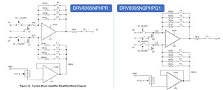

We are not sure that the impact of the circuit difference of DC_CAL(SPI).

    I am not too sure about whether the CSA has any major differences, but the DC_CAL CSA calibration procedure is best done while the system is not switching, so I am not expecting the differences in the side-by-side diagram you shared to cause any problems in the system

    <DC_CAL CSA>
    We understood the device differential regarding LDO.
    -DRV8305NP(Current): External Voltage reference type (VREG/VREF: we connected external 3.3V)
    -DRV8305NQ(Swapped): External Voltage reference type (VREG/VREF: we connected external 3.3V)
    And regarding DC_CAL CSA calibration, from your comment, we understood the impact is negligible.

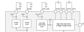

    <Charge Pump Setting>
    We also concern about the differential of charge pump setting.
    Current setting is default 0x0 (RSVD, none setting parameter for charge pump), but default 0x0 of Q1 type is charge pump frequency setting to "518kHz center".
    We also tried to swap both ICs to Q1 type without change FW, then, motor driving when low speed was not operated smoothly. (repeat stop and move)
    So we would like to know whether this differential could be affected to motor driving characteristics especially low speed (high torque) condition.

    Moving onto the next topics to debug:
    1. If you are seeing a 'VCPH_OVLO_ABS' type fault, then this means the charge pump is probably experiencing too much voltage above the rated spec and that's why it's reporting a fault in SPI and possibly nFAULT pin voltage
      1. The datasheet recommendations for charge-pump related components (flying cap, storage cap) are the same -> so I don't think there would need to be any update to layout or component selection between the two devices
      2. It may be helpful to capture a waveform of the voltage waveforms for VCP, VM, CP1H/L, CP2H/L to observe what's going on
      3. I don't think there is a difference in this parameter between DRV8305 and DRV8305-Q1, but the scope captures will tell us more info on whether this is the root cause of the problem
      4. charge pump freq SPI register bit could be something to look into -> let me ask the team about this. Although it does seem like the default setting is being used in both cases anyway
