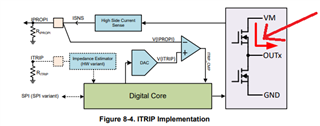

I am trying to apply the electromagnetic brake with the DRV8245-Q1.
I want to control the current by feeding back the current flowing through the electromagnetic brake, but when I checked it on the evaluation board, the voltage of IPROPI was 5 μs behind Vout.
Why is the operation of IPROPI delayed by 5 μs with respect to the output voltage?
Is it possible to reduce this delay?
Pin setting
IPROPI: 1.0kΩ
ITRIP: LVL1
SLEW RATE: LVL1
DIAG: LVL1
MODE: LVL2
VVM:12V
IN1 PWM DUTY Cycle:40%
Ramp Rate1:0
CH1:VIN CH2:VOUT CH3:VIPROPI
