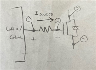

  • Hi Jenson,
    For simplicity purposes, average gate drive current can be estimated by the following equation:
    However, you can also estimate instantaneous peak gate drive (source or sink) with the following equation:
    where t_rise is the rise/fall time of the MOSFET's VDS slew rate.
    When VDS slews, this is during the Miller plateau of the MOSFET's Vgs waveform as shown below.
    To calculate the Miller plateau on an oscilloscope, you'll need to measure VGS with a differential probe, or calculate the gate voltage and source voltage on separate channels then use a math channel to calculate the difference.
    For the gate voltage waveform, you'll also probe before and after the series gate resistor to measure the voltage difference across the resistor during the Miller plateau. The voltage difference across the gate resistor during the miller plateau, divided by the resistance value, yields the instant gate current as well.
    I've drawn where to probe below to measure the gate waveforms.
    Aaron
