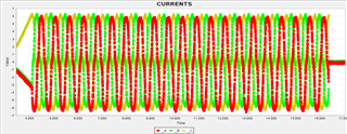

Our approach to DC offset calibration is to move the motor in an open-loop control mode to measure each phase current amplitude (find min/max values) and set each offset so that the waveforms are perfectly in the center around zero. This calibration works really well, even better than simply measuring the startup offsets to zero level and subtracting them. Here's proof for that:
simple calibration (done during every startup, simply average measured DC offset and subtract so that the zero-current level is at true zero)
calibration during openloop movement:
there's clearly an improvement in the waveform alignment which results in smoother operation (especially in haptic devices).

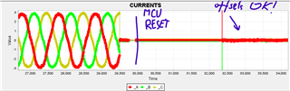

However, this is where the problems start - in order not to repeat the open-loop sequence the offsets are just saved in flash memory after the initial calibration routine. They stay the same after each power-up. This is not the case when it comes to the DRV amplifier "zero" level. It's clearly noticeable that the DRV changes its amplifier output zero levels between start-ups, that are even a few seconds apart. Actually, even an MCU reset can cause problems (essentially just toggling EN pin - the DRV is in 3x PWM mode so EN is shorted to INLx).
We are using only phases B and C for measurements, the A is determined from Kirchoff's current law.

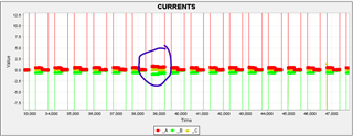

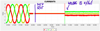

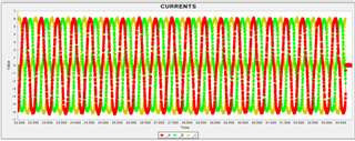

GOOD calibration outcome:
WRONG calibration outcome:
You can clearly see that before the calibration the determined offsets were correct, bringing all three waveforms to the same level. However, after the reset, the B phase is off, even though the offsets are read from flash memory.

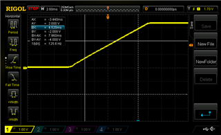

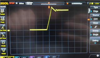

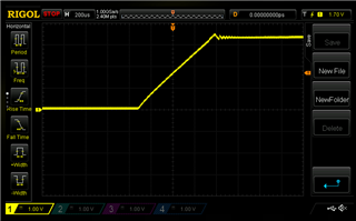

Initially, we thought it's related to the lack of the CAL pin and the automatic routine that is performed in the first 50us after the VREF crosses the minimum voltage level. The voltage level on VREF during startup is not that clean due to the buck starting up (the voltage is measured directly at the VREF cap with spring oscilloscope contact):
SPI version (with integrated buck):
Hardware version (external buck):

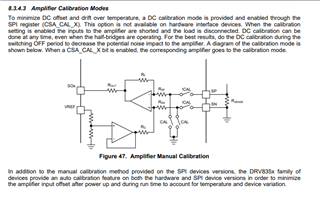

As can be seen, there are some voltage ripples near the 3.3V level, especially in the SPI version with a built-in buck. Looking at this and the internal diagram:
We saw that VREF is one of the sources that can disrupt the calib process since SP/SN are totally disconnected. Since autocalibration needs around 50us it seemed to be quite a good guess and this is why we made the soft start of the external buck in the HW version much longer:
This unfortunately did not solve the problem.

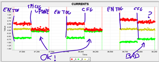

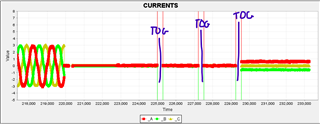

  • I've done some more tests and it seems a simple EN pin toggle can break the B offset:
    SPI version:
    where TOG is reset EN pin wait 300ms set EN pin, wait 300ms, perform SPi update. It's clearly visible that once in a while the B offset is off, but sometimes it gets better ofter the SPI config upload.

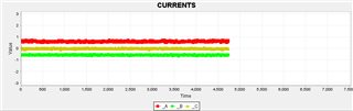

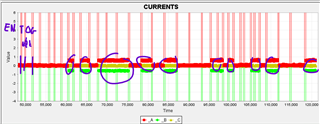

    The next image is for the scale of how often the offsets fail:
    This seems to be a more often anomaly on the HW version:

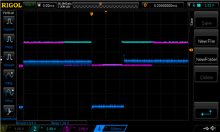

  • Dear Aaron,

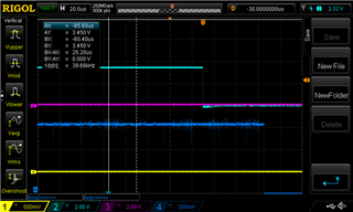

    Thank you for your analysis! In order to make sure I conducted the following experiment:
    I cut the connection between EN and INLx. I connected INLx to a free GPIO leaving the EN connected to the previous GPIO. During toggle event I did the following steps:
    - turn off timer outputs
    - wait 10ms
    - INLx set low
    - wait 10ms
    - EN low
    - wait 10ms
    - EN high
    - wait 10ms
    - INLx set high
    This sequence can be seen on the scope below:
    where CH2 = EN  , CH3 = INLx, CH4 = SOB

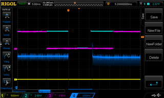

    here's the transition form good offsets to bad offsets:
    Here's what I've found out - when the SOB is transitioning form "correct" offset to "bad" offset (and vice versa) the "bad" offset part is very noisy. After zooming in and measuring noise frequency I can see it's around 40kHz which is close to our FOC loop. The timers are off, though. This must be the ADC that is charging it's internal SAR capacitor. You can see it clearly here:
    I hope the negative spikes on ch4 are visible.
    Is it possible that the DRV changes It's SOB pin impedance somehow? When I place a small capacitor between SOB and GND the issue is much less common (like two times in 200 EN toggles, whereas without it it's like 100 in 200 toggles)

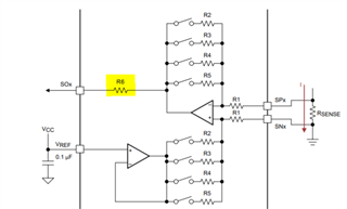

  • Hi Piotr,
    Something I discovered is that R6 does not actually exist in the datasheet, therefore impedance from SOx output is variable based on the GAIN setting used. I am not sure if output impedance changes with frequency as this characterization data exists, so this may explain some root cause with seeing different CSA outputs depending on the PWM frequency. Does this offset improve with higher/lower PWM frequencies?
    How much load capacitance is the internal SAR? I'm not sure how much load capacitance affects the SOx output, or even parasitic capacitance on the SOx trace.
    If the issue still persists, is it possible to return back to the intended way of CSA calibration through the device in hardware? Typically customers implement the RC filter at the SOx output and use the CAL pin to calibrate upon device powerup before enabling the device and applying PWM outputs.
    Aaron
  • Hi Aaron,
    Today I didn't get a chance to test the lower/higher PWM frequencies, but actually, this modification is off the table since we have optimized our system for 40kHz.
    However, I've found these specs:
    can we assume that at DC the R6 is around 1k (based on the above specs)?

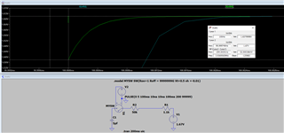

    The STM32G4 ADC specs:
    I have run a simple LTSpice simulation based on these specs and measured how much a 5pf cap with 50k in parallel can drain the SOx pin voltage (the green voltage is the voltage between the 50k and 1.1k resistors):
    It's around 30mV which is far from the measured 200mV spikes (when the offset is "wrong") but closer to the 80mV spikes (when the offset is correct). I'm aware I didn't add any trace parasitics or did not consider the oscilloscope probe, this is just to see what range of voltages we're talking about - they seem to be ok. What do you think about that? Can it be a DRV's internal error?

    1) You said before VREF was not clean before. DRV835x has an automatic CAL routine at startup, so even though there's no CAL pin, it will calibrate based on the VREF voltage present at that moment once the device has waken up. Can you confirm with an external steady VREF voltage if the offset goes away or still appears?
