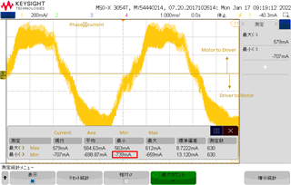

5. I tried Manual Tuning from the GUI --Guided tuning settings --Inproving speed regulation, but the motor didn't spin well in a closed loop and it stopped.
Step A-D: I disabled the speed loop and closed loop, and I measured the A phase current.
Step E: I didn't know what to fill in, but I entered the maximum measurement: 739 [mA] * 110 [%] = 813 in [FORCE_IQ_REF_SPEED_LOOP_DIS].
Step F: When I re-enable the closed loop, the motor stops and I can't proceed to the next step.
As a test, I changed [FORCE_IQ_REF_SPEED_LOOP_DIS] in the range 600-1000, but the closed loop didn't work.
The smaller this value, the larger the current when the motor stopped.
