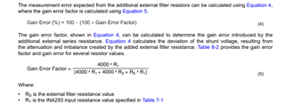

I have a question about the half bridge driver DRV8343-Q1 SPI version
Here, the low-side current feedback concerns: What does the gain Error formula look like when you use an input filter? like for example INA293 on page 16, Can I get a formula to calculate the additional gain error?
  • Hi Muffin,
    You can use the same equations to calculate the input filter resistors:
    Input resistances for the DRV8343-Q1 is 10kohm.
    Aaron
