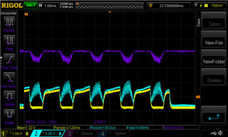

When I check the output on a 'scope I see both outputs in phase with each other.  At low RTPIN settings they just cancel each other out.  At higher settings one side starts a half-wave that drives the LRA but not at the expected frequency.  I see 470 Hz instead of the expected 235Hz

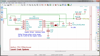

    Can you share your schematic? can you also check the connections of the LRA? is looks like there may be a poor connection on one of the terminals
    Arthur
  • Thanks Arthur,
    Here is the haptic section of the schematic. The Vunreg is coming from a 4.2V LiPo battery
    I checked by connections and they look solid.  I did notice though that if I attach the LRA to a mass (AA battery) the auto calibration starts to fail (status register doesn't have 0x08 bit set).
    Phil

    Also, as a note. in the waveform you see the switching portion of the waveform, and the sort of smooth in phase portion. the switching portion is the actual driving voltage, and smooth in phase portion is the bias voltage of the front end ADC, trying to read the back emf. as you can see there is only one side of the LRA driver driving, this tends me to believe that it is not getting a valid BEMF voltage to measure.
    You should review 7.5.6 Auto Calibration Procedure in the data sheet and try to get calibration to pass, as you know this devices schematic is very simple, and if the LRA is connected correctly it should just be a bit of register settings to get it running.

    Can you share the waveforms in the current state again?
