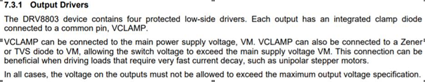

  • Q4:In below features we mentioned Vclamp has two ways of connection. But can we float the Vclamp instead? What is the consequence if float Vclamp?  Customer has another power supply to connect VM. They don’t want to connect VClamp to VM.

    4)  Can you draw the circuit the customer wants to use?  We do NOT recommend leaving VCLAMP unconnected.
