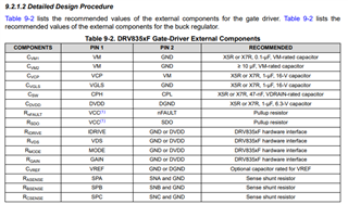

    One other thing I wanted to ask: what is your system's nominal operating voltage for VM and Vdrain?
    One important consideration we stress to our customers for DRV devices is to have properly rated components, especially for bypass/bulk capacitors near the DRV device inputs and MOSFET power stage.
    The best-practices we recommend are to make sure your device has all of the necessary external components at proper values listed on the 'Figure 8-2. Block diagram for DRV8350FS' and to also reference the 'External Components' table below.
    Especially for the CPH/L cap, VM caps, VDRAIN caps, they should be rated for 2x the operating voltage expected.
    • This is because MOSFET VDRAIN voltage can overshoot to 2x during special operating conditions like braking
    Andrew

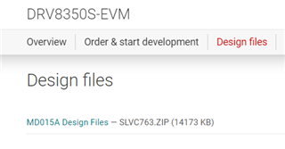

  • Hi Mike, Lukas,
    One last thing - please see these EVM design files as the reference for your layout.
    There will definitely be some useful reference layout to show how the grounding planes and high-power planes need to be set up
    https://www.ti.com/tool/DRV8350S-EVM#design-files
