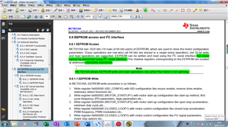

Here's some issues from the customer may need your help:
1) As the figure below, the manual states that EEPROM reads and writes are to be performed while the motor is stationary. Dose that mean when the motor speed is not 0, read and write will fail? The only judgment is if the motor is stationary. Correct? But if reading and writing to EEPROM with motor speed other than 0, how to tell if the read data is abnormal?

  • Hi Cherry,
    1) If the motor is spinning, EEPROM read/write command is held until the motor stops and enters idle state, then the EEPROM write/read is executed. User would need to read back the EEPROM register after the write command has been issued to verify that the EEPROM write has completed successfully. After setting the EEPROM_READ or EEPROM_WRT bit, the user can also check and see of these bits are automatically reset to 0, which indicates that EEPROM read/write is completed.
    Please also keep in mind that the EEPROM_WRITE_ACCESS_KEY needs to be set to 0xA5 while setting the EEPROM_WRT bit in order for the write command to take effect.
