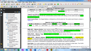

1) In the 24bit control bit, MEM_SEC occupies 4 bits, MEM_PAGE 4, and MEM_ADDR occupies 12, so the total address bit is 20 bits. Is the 22 bit highlighted in the following figure wrong?

  • Hi Cherry,
    Please see the answers to the customer questions below.
    1) The 20-bit address is actually converted to 22-bit address internally via a lookup table, hence the wording "constructed internally by MCT8316A …" However, the user shouldn't need to worry about this and can simply treat the memory address as 20-bit.
    2) The descriptions for MEM_SEC and MEM_PAGE are also unnecessary and confusing. Users simply need to do the following for all relevant EEPROM and RAM registers that they would need to access:
    • set 4-bit MEM_SEC to 0x0
    • set 4-bit MEM_PAGE to 0x0
    • set 12-bit MEM_ADDR to last 12 bits of regmap address
    We will update the datasheet to avoid confusion in the future.
