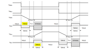

    If excessive capacitance is present at the gate drive outputs, then too little IDRIVE current can also cause potential issues as well. First, you want to ensure enough gate drive current turns the MOSFETs on and off to avoid shoot through current conditions. Ideal timing diagram is below.
    Too slow of a gate drive current may cause VGS rise/fall time to be too long with potential shoot through if VGS > Vth for high side and low side MOSFETs. This is due to RC time constant of gate rise and fall times. The higher RC value can be caused by:
    • Gate resistors limiting gate current
    • Capacitors from gate to source
    • Small IDRIVE currents
    • Higher MOSFET Qgd values
    In reviewing the schematic, I see there are gate to source capacitors on the LS FETs. Can you remove these and see if gate driver performance improves?
    The device has selectable IDRIVE source and sink current settings, which removes the need for external sink diodes. The gate resistors are okay, but we recommend starting with 0-ohm resistors so gate current can be selected via the IDRIVE registers in SPI.
    The MOSFETs used are 3nC Qgd, which is a very small value. We recommend the VDS rise/fall time to be no faster than 100ns, so we recommend choosing an IDRIVE setting no more than 3nC/100ns = 30mA. You do not need much gate drive current to turn on these FETs, 100mA may be slewing VDS too fast and causing damage at the GLx gates via negative transients.

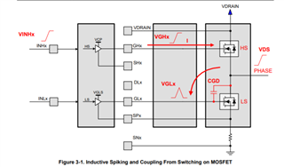

    I am referring to the external MOSFETs. Device uses an internal state machine to ensure GHx and GLx are not turned on at the same time via dead time.
    Please monitor GHx/SHx/GLx waveforms and ensure that VDS slew rate of HS MOSFET (VDRAIN-SHx) and LS MOSFET (SHx-GND) is 100ns or slower to reduce inductive spiking at the powerstage. Spiking too quickly can cause damage as shown in dV/dt coupling below.
    Please read this app note on power stage design for higher power motors: www.ti.com/.../slvaf66

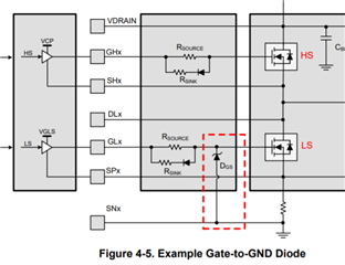

  • Is this gate-to-gnd diode the same as the one added in the high side like the picture.And is the reason why the high side GHx are working well?
  • Hi Shengzong,
    Yes, high side only includes VGS gate-to-ground diode. This is a 15-V rated Zener clamp diode to protect GHx from rising to 15V over SHx. VCP needs to be more protected than the low side VGS because VCP-VM ESD diode can be damaged if VCP increases to 15-V over SHx (or VGSH = 15V).
    VGSL (low side VGS) can tolerate higher gate voltage because VGLS regulator is operational to 20-V max. Hence gate-to-GND diode is not in device design. You can implement an external gate-to-GND diode on the low side VGS to protect against negative GLx voltages, or mitigate inductances in the power stage.
