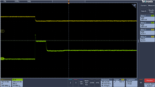

Could you please see attached waveform
Image of Vin voltage ① and current waveform ④ when DC24V is applied (DC24Vin.png) and DC18V is applied (DC18Vin.png)

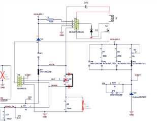

  • Hi Shinichi,
    → Q2 and D1 are not used, the power transistor (R6020) and diode (RF2001) are connected externally, and the load is connected to the coil.
    Could you please see attached connection image.
    I think this is where the problem is coming from. Below is a schematic drawing on how to properly connect the external diode and FET along with the power supply. Note that JP7 is shorted and Q2 is removed from the PCB and pin 2-3 are shorted.
    One more thing I recommend is not trying EN pin to external supply. Just leave the EN pin floating (unconnected). There is an internal pull-up resistor on EN which will enable the device when EN is open. This is a more reliable way to enable the device than pulling EN high.
    Also, What is the value of VIN? Is it equal to 24V? If Vin is higher than 14V, a limiting resistor on the VIN line will be required as specified in the datasheet (see below for recommended resistor values). If VIN=24V, R10 on the EVM should be replaced with 9kΩ. If VIN current is not limited properly, it can cause damage to the IC and even cause current regulation issues.

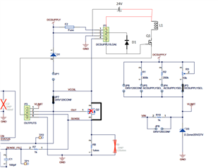

  • Hi Pablo,
    The customer has a question about your suggestion.
    Could you please confirm and advise.
    (1) If pin 2-3 of Q2 is short-circuited, OUT and SENSE will be short-circuited.
    A short circuit occurs between G and S of the transistor.
    I think it should be only removed Q1.
    (2) The connection destination on the anode side of D1 should be Drain of Q1.
    In other words, D1 is parallel to L1.
    Could you please see below.
    (3) Vin is normally 24V, experimentally 15V.
    So R10 should be 9kom when Vin is 24V and 500ohm when Vin is 15V.
    Could you please confirm if the customer's phenomenon can be reproduced under these conditions.
    I appreciate your great help and cooperation.
    Shinichi
  • Hi Shinishi,
    Thanks for catching this mistake, I failed to see this short. So just remove the FET.
    Yes. That is correct.
    After implementing the set-up with the corrections, they should be able to get proper functionality.
