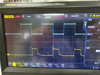

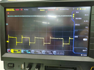

1) Regarding the drive waveform of 8256E, the description in spec is "The EN input drives the waveform PWM, and the PH pin inputs the direction signal so that out1 and out2 output the corresponding waveform".
The following two figures correspond to 100% and 50% of the EN pin input (blue input and yellow output), and the output waveforms are 50% and 25%, respectively,  which is different from what the spec shows:

    For the first question, what is the state of the PH pin for scope captures shown?

  • 1. When the load is too high, the PH pin will pull down.
