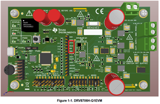

I have a DRV8706H-Q1 evaluation board with M430F2617T controller. Here, I would like to control the Motor Driver through an external controller by SPI Communication and break the connection between M430F2617T and DRV8706H-Q1. I would like to know the hardware changes that has to be made in-order to control the DRV8706H-Q1 by an external controller.
I have removed the following resistors that connects the DRV with M430F2617T still unable to communicate with the external controller:
nSCS, SCLK, SDI, SDO, IN1/EN, nHIZ1, IN2/PH, nHIZ2, nSLEEP, DRVOFF, SO.
Looking forward for the quick response.

  • Dhanush,
    Pulling the resistors and making connections to external board should be the answer, but I am a little confused on how you plan to "communicate" with the DRV8706H device.  There is no SPI interface on the DRV8706H.  You would need the DRV8706S.
    Ryan

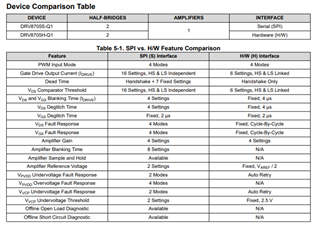

  • As per the attached picture of DRV8706H-Q1, I can see the SPI Pins(nSCS, SCLK, SDi, SDO) which have been highlighted in RED color. Please confirm that if these pins are connected to the DRV8706H-Q1.
    Please find this table in the datasheet.  It is NOT possible to control the "H" EVM with SPI.  You will need a "S" EVM.
    We use the same board hardware for DRV8705S and DRV8705H, that is why you see the labels for SPI.
    Ryan
