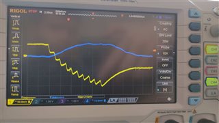

I have noticed 500mA or so current spikes on PVDD pin apart from normal 35mA power consumption. This has been measured while no PWM signal was applied to the driver and the gates were enabled. After disabling gates, no spikes are visible. At first, I connected it to gate charge pumps, but the frequency of them is far too low (8.3kHz) unless charge pump works in hiccup mode even when no transistors are driven. Could you tell me, if this is a bad measurement method, something is wrong with my design, or if it is a normal operation?

    This is pretty noisy. The 8.3kHz seems pretty low if this is not PWM frequency. There also appears to be very high frequency lower amplitude noise as well between the 8.3kHz pulses. Is there inductance between the supply and system, i.e. long wires?
    Are you using a clean power supply or battery? When EN_GATE is low, VCP_LSD and the tripler charge pump is disabled. Can you check if this noise is also apparent at the VCPH and VCP_LSP pins? The required bypass caps should be placed close to the driver IC, or else long current loops and added inductance can cause noise at these pins. Also please ensure that the device is soldered correctly and PVDD bypass caps are placed close to the IC as well.

    PWM frequency is much higher, the test was performed with a better setup ie. shorter leads and lower value shunt resistor, and the high frequency spikes disappeared, while the big ones stayed. We are using linear lab power supply. All bypass capacitors are within 7mm of IC and everything has solid copper plane underneath. Voltage on VCP_LSP is solid 12V, and VCPH is 24V. I didn't yet measure currents on these pins, but it must be something connected to the driver because once we disable gates, spikes go away. As for soldering, we have three identical test boards and they all show the same behavior. I doubt we could go wrong with soldering three times. We'll be probing more in the meantime, if anything changes we'll let you know, but as of now - we're pretty much out of ideas.

    Can you also check CP1H, CP1L, CP2H, CP2L, VCPH, and VCP_LSD with respect to GND to see if there is also any 8.3kHz noise similar to PVDD? It is possible that the charge pump controller is operating very slowly and coupling into PVDD because a small IDRIVE setting is used. When EN_GATE goes low, the charge pump is disabled so this would remove the noise.

    It turns out, that charge pump is periodically switching on and off with this frequency. On the attached shots blue is current and yellow is voltage (first photo is supply, second VCPH). I guess there is nothing we can do about it apart from LC filter...
