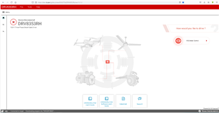

I try to evaluate the DRV8353RH-EVM Board.
I installed the DRV8353Rx 1.0.1 application on Windows 10.

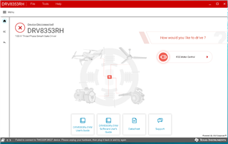

When I try to connect to the DRV8353RH-EVM, I have the error : "Failed to connect to TMS320F28027 device: Please unplug your hardware, then plug it back in and try again"
=> See picture attached.Application : unable to connect
However USB drivers seems to be ok.

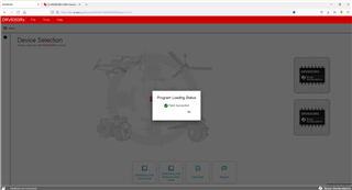

I tried to connect with the online application, the programm seems to be downloaded correctly to the TMS320F28027 (My supply voltage display that current varies during the download).
Once the programm is downloaded, the problem stay the same : I have the error message : "Hardware not Connected."
Programming_ok_with_offline

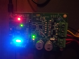

I followed GUI Guide instructions, and led seems to be ok (see picture of the card).
What could be the reason ? What could I do to find the issue ?

    Could you provide a waveform showing nFault during the flashing of the device as well as the 3V3 voltage? I want to see if there is any fault that occurs during flashing, or if 3V3 supply dips while the F28027 is flashing, possibly causing it to fail to fully connect. Also, could you double check to ensure that the F28027 launchpad is mated correctly onto the EVM? Have you tried switching out the USB cable?
    Anthony Lodi
    Here is a picture of the card during the flash (Just a picture, not a video because there is no change during the programming).
    I already checked the F28027 dips : OK (Well connected)
    I already plug/unplug USB port (and change the USB cable) : same result.

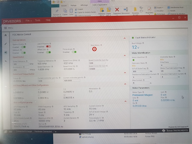

  • Thank you anthony ! I have more questions now, do I need to open a new post ?
    1. Resistance measured by estimation seems to be twice the resistance value indicated in motor datasheet, is it normal ? Is ut resistance beetwen A and B phase of the motor ?
    2. Inductance (Ls-d and Ls-q) has not been measured. I measured it with a 10kHz Sine waveform and i found 4 microHenri. Do you think a normal value ? (It is a small brushless motor). Is this method ok to measure inductance ?
    3.Flux : estimation is 0.021V/Hz. How could I measure it with instruments to check if the value is correct ?
    I attached a screenshot of software for information.
    Thank you in advance !
