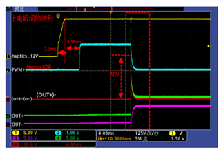

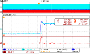

Q4: When out+ rises from 0 V to 6 V during power up, a pulse is generated, why is this pulse generated? How is this pulse filtered out?

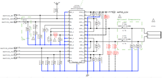

And the schematic is as follows:
Could you help check this case? Thanks.

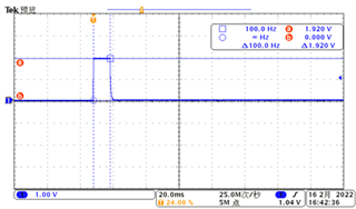

    Q3: When the power supply is powered up, the IC itself generates a PWM pulse of 10 ms. Why is that?
    Where is this pulse being seen? is this at the OUT+/OUT- pins of the amplifier? is there a similar pulse at the input pins?

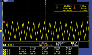

    When no capacitance is added, the waveform is a normal square wave. Why does this cause the OCP to be flagged? What is the OCP tagged standard? Is it labeled as soon as 13 A is reached?
    If the input is tied to GND, then the amplifier will be operating in a non-linear region, this will cause a slight increase in THD. Using a voltage divider, or a cap to GND will have better THD performance. Since a Cap to GND uses less passive components the capacitor method is recommended.
    They have attempted to use a capacitor to ground when designing, but it could result in excessive current and significantly increased back-end vibration. What is the reason for that?
    It is being seen at the PWM+ pin of the IC. Out+ will have a short pulse (up to around 30 V) during a change from 0 to 6 V, as above Q4.
    the OCP should only trip once the 13A limit is reached. If the flag is being set I suspect that it is truly because this limit is reached
    Can you explain more what you mean by "back end vibration" and "significant current". is there a DC current through the load?
    I wouldn't expect that the input pins of this IC are able to drive 6V, If R711 is removed is the pulse still seen?

    This pulse is still present after the R711 is removed.

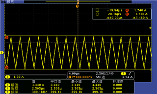

    Also, what causes the pulses at the output and How to filter out? When testing the output, the inductor front end out+/out- will be offset (i.e., there will be a glitch when out+ - out-, as shown in the following figure)

    I understand that this pulse is generated by the DRV itself. I searched around E2E and found some other threads mentioning the same phenomenon. I will test this in the Lab and see if I can see the same

    I will make this my first priority once I am in the office tomorrow (in about 12 Hrs) I tested this briefly, and was able to recreate a small pulse at the output. I will do some more testing tomorrow and provide recommendations/explanation
    Arthur

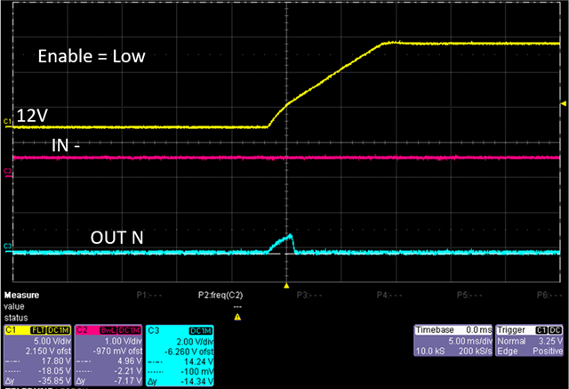

  • HI Jiawei,
    I was able to replicate the same pulse behavior on an EVM.
    There will be a pulse at IN+/- when the  device is enabled with the EN pin.
    I was able to remove this pulse if I power the device with EN = Low.

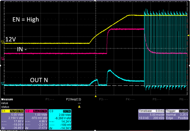

    When I power the device with EN = High and STDBY = Low. I see there is also a differential pulse on the outputs
    To remove this pulse
    1) power the device with EN = Low and STDBY = High
    To Play a vibration
    2)Enable the device by setting  EN = High and STDBY = High
    3) Play a waveform to the IN+ pin with EN = High and STDBY = High
    4) Set EN = High and STDBY = Low. This will allow the vibration to be felt
    Also, please as the customer to check the resistance of IN+/IN- to GND, and the resistance of  OUTP/OUTN to GND and each other.
    I want to make sure that there is no short causing the OC detection to be tripped.
    Arthur

    See below feedback pls. Another question is that the inductance  will heating when the output has no load, could you kindly tell me the reason? Tanks!
    PWM+           1.9kΩ
    PWM-           0(0Ω电阻接地)
    Out+             285kΩ

    Do you mean that when there is no load connected and no waveform being played inductor L703 and 704 heat up?
    if the device is active the Idle state of  OUTP/OUTN will be a 50% duty cycle square wave. This will be in phase between both the outputs, but the current to charge/discharge capacitor C723,724  may be the cause of this heating.
    Can the customer take scope shots of the OUTP OUTN terminals during the Inductor heating condition?
