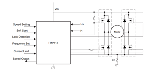

Is it possible to use TMP815 for brushed DC motor making some modification to the external circuitry
Hi Akash,
According to the simplified schematic, it drives a brushed DC motor (not BLDC). The description "18-V max sensored single-phase BLDC gate driver" is incorrect.
Aaron
