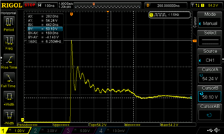

we have followed “[FAQ] Proper RC Snubber Design for Motor Drivers”
Our system is a DRV8353 with a 48V lithium battery.
Attached oscilloscope probe at VCC at drain on phase and GND at motor output(source).
Here is the first scope images without any snubbers

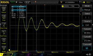

We then used a 100pF 100V capacitor and a 0R resistor and this is the image we got.
Next image is same measurements on lower mosfet, with 100pF capacitor from previous scope image
High side motor at 2A,
First three scope images is done at same motor load.
Can't see in the guide what ringing values are acceptable, so asking here if this look ok.
