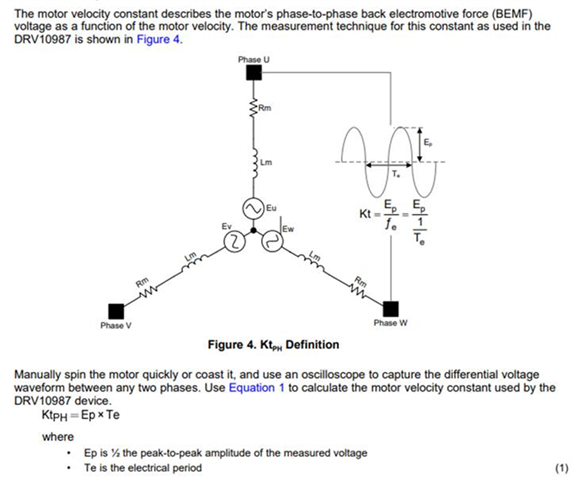

  • Hi Sebastien,
    I was able to get information on calculating flux. The units for flux is V/Hz, and describes the relationship between the BEMF voltage generated by the motor and the speed of the motor. To calculate the flux you can follow the steps outlined below:
    This information is found in the DRV10987 tuning guide, but the information is still valid for the flux calculation in your situation.
    Anthony Lodi
  • Thank you Anthony !
    We measured our motor : 100mV peak to peak at 10Hz. So 0,005V/Hz.
