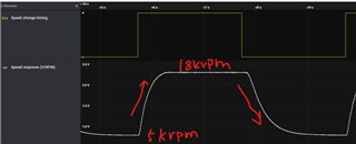

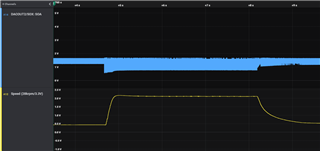

I want to improve speed response of acceleration and deceleration.
But, [CONST_SPEED] register of [CLOSED_LOOP_MODE = Speed Loop] not works.
There is no speed response change even if the values of Kp and Ki are changed.
