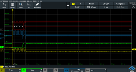

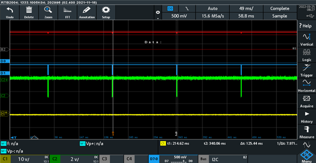

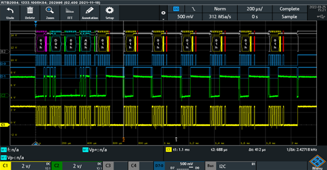

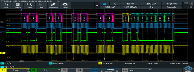

    I work with Oliver and Ricardo and we made further tests here. Below I will describe everything that we've done so far and also share some data about the tests.
    1) About our hardware setup:
    We are using the evaluation board MCT8316AEVM with the driver chip replaced with the MCF8316A1VRGFR model.

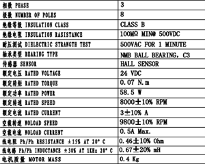

    The motor that we are using have the following parameters:
    2) Initial Test using GUI:
    2.1 Test Setup
    Using the setup above and the GUI provided by TI we started to experience some spourious motor locks, so the screen stops working and the motor stops or stayed in a fixed speed, and only if we make a power up cycle on the MCF8316 it returned to operate. This is easy to occur and the steps are listed below how to reproduce:

    2.2 Analysis of I2C
    To be sure about the origin of this problem we inspected the I2C lines to see whats happens when the device crashes.
    With the GUI using the test setup (2.1) we can see that the microcontroller asks for data each 125 ms to the MCF8316A.
    When the crash occurs we can see a sequence of NAKs happening and then the GUI application disconnects from target and the MCF8316A stay locked in fixed speed. Interesting things:
    1) Only after a power cycle of MCF8316A it will work again
    2) If we reset only the microcontroller from the board the MCF8316A does not work, it needs a power cycle of MCF8316A to work again.
    The picture related to the behavior of the NAKs is below:
    After recording this waveform we notice that the timing associated with the I2C is out of specification regard to time between I2C bytes.
    In page 71 we have a note in section 7.6.2 that state as follow: "For reliable communication, a 100-µs delay should be used between every byte transferred over the I2C bus."
    After reading this we are sure that the embedded software provided by Texas in not compliant with this statement, to check if this could be the reason to continuous NAKs in I2C bus we got a base software of the eval in the topic of forum, and modifying the code we implemented the 100us delay between the I2C communication bytes.
    With the new software in the microcontroller evaluation we didn't notice any other NAK behavior, however, we still see some locks.

    4.Using a digital oscilloscope we added spies on I2C line and Fgout.
    Below are some picture of I2C lines and FGOUT(orange trace):
    So, we faced another issue, when the motor was running and we were reading the speed and theta register, suddenly the motor stopped, without fault , and we couldn't more run the motor until the driver to be reset (I2C still have communication normally).
    Here below are some important point about this test:
