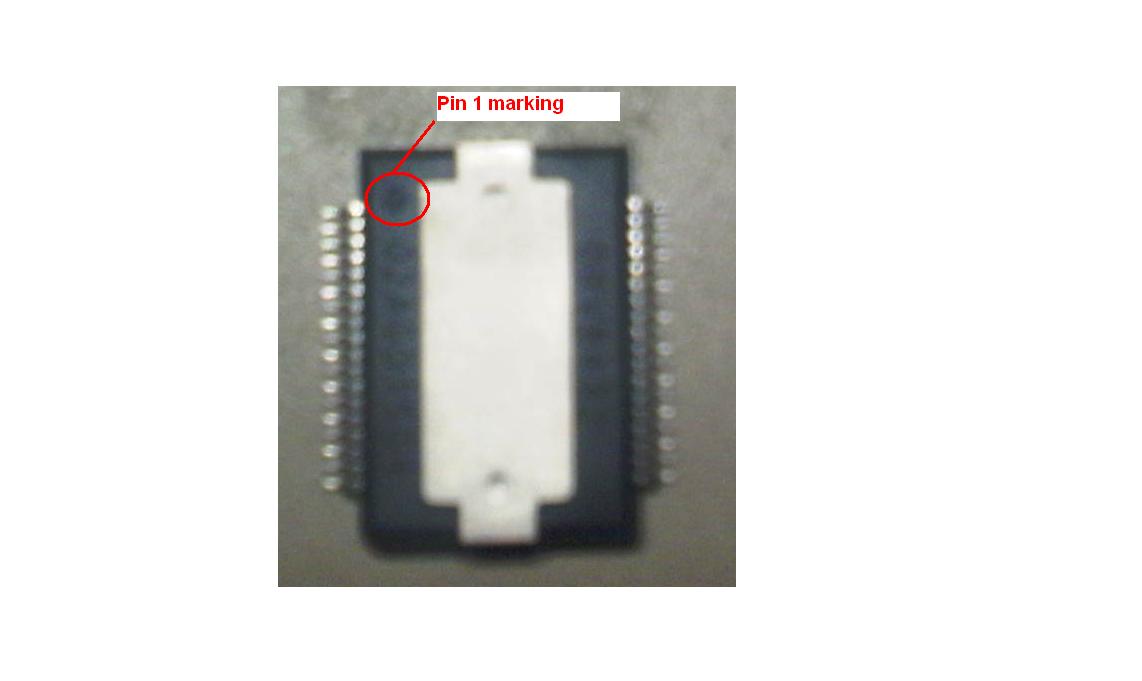

  • Ryan, I too need an evaluation board. We have designed a product, and layout, and aquired PCB's. But when we went to mount the DRV8432, there were markings that might be Pin 1 on top and bottom of the chip. Ugh! So we made our best guess. We were pretty sure we were right, best we could tell from the data sheets. It of course failed. We need an example! Ready to bring this product to market, only don't know if it is oriented right, or we have layout problems. Would like to see an example working board to know either way. rmd@newmicros.com
  • Randy,
    There is a small circle on the top of the device that indicates pin 1.  It is hard to see in a dim light.  Put a bright light on the chip and angle it slightly to see it up in one corner of the device.
    I have attached a quick picture I took below....it is out of focus, but you can barely make out the small marking that I circled in RED.
