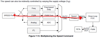

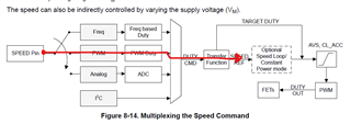

I want to know the delay time of speed set is, from speed input to controller.
How long does it take with MCF8316A and MCT8316A?
I use PWM Duty mode for SPEED input.
MCF8316A
MCT8316A
Kenji,
Controller should be able to detect the speed based on the PWM signal in less than 1 ms. This applies to both devices.
