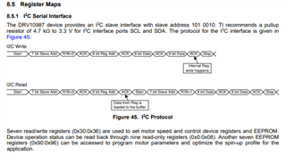

  • Marc,
    Are you using the DRV10987EVM and GUI or your own customized board and MCU to send I2C commands? Can you check if you followed the I2C protocol instructions and the correct slave address as mentioned in the datasheet?
    Vishnu
  • Hello Vishnu,
    I am using a custom board. Firstly I was using I2C commands to send speed command and read speed feedback, fault register and motor current. Now I am only using I2C to for register reading, speed commands are sent through PWM.
    Most of the time, read accesses works as expected (no communication error and meaningful data). I followed datasheet instructions for my implementation.
