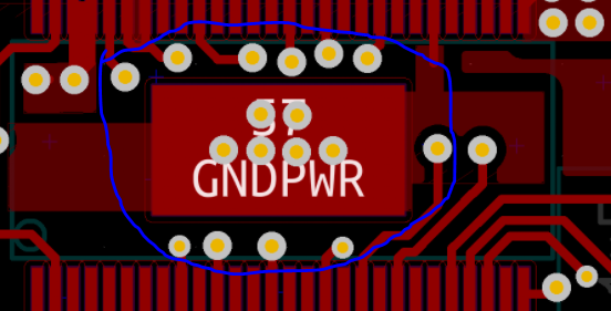

  • Hi anthony, talha here. Me and Mohammed are working together on this project. We have disabled buck completely (En-Buck connected to GND) just in case the regulator was causing these issues. PVDD1 is 24V and PVDD2 is 24v as well. I'm attaching images of our design here for your reference perhaps something in the pcb layout is obviously wrong or not standard?
    Pin1 is bottom left
    Top layerIn1In2Bottom layer
  • Hi Talha,
    Nothing stands out to me as obviously the issue when looking at the layout. Are the vias tented? I could see a scenario where a solder bridge could be occurring between the GND pad of the DRV and the vias that are near the ground pad if the vias are not tented.
    Can you measure how much current is being consumed by the device after power on? is the voltage at the DVDD pin also 0V? Or is it outputting 3.3V?
    Could you send a good quality picture of the IC on your board to see if I can see anything that could be a problem from the physical connections? You could also try to measure the impedance between the PVDD pins and GND to see if there is a low impedance path.
    One side note is that I wouldn't recommend putting the CP1-CP2 capacitor on the bottom of the board, since this results in added inductance in that path since it has to go through 2 vias which can negatively impact the performance of the trickle charge pump.
    Anthony Lodi
