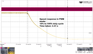

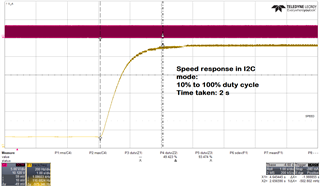

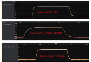

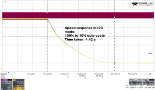

Why speed response is different depending on the speed input command?
Below is the speed response when switching from 10% to 90% of speed (step input) and from 10% to 90% speed using the same PID parameters.
I want to use PWM duty mode for speed input.
How can I improve the response of PWM duty mode?
I want to do the same as I2C speed input response.
I2C mode:
PWM duty mode:
This is too slow. I want to the same speed response, like I2C speed input.

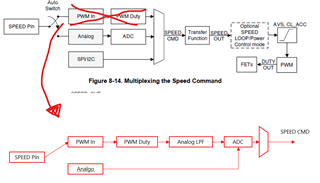

Does it take time to recognize the speed? Are you using any filters, is it possible to change the order?
